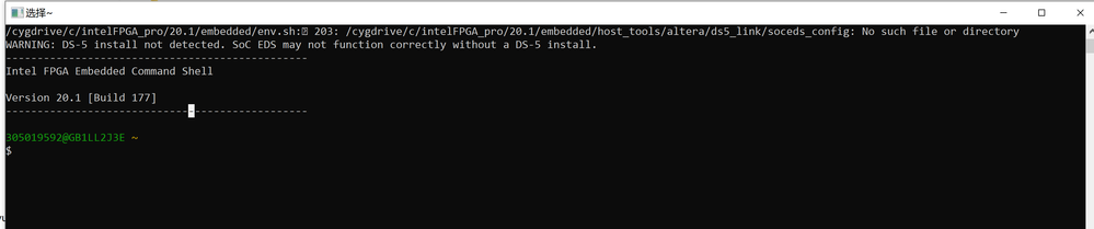

      and after these steps done, i waitted for serveral hours, the installer screen stopped without any information to inform me the installation completed, you can see the information details i attached in the first post.
      and i checked 2 folders appeared in the path( C:\intelFPGA_pro\20.1\embedded\host_tools\linaro)
      one is gcc, the other is newlib-cygwin.
      pls tell me how can i know the installation is successfully completed?
      i also attached the printed screen after i start the EDS command shell for your reference.
