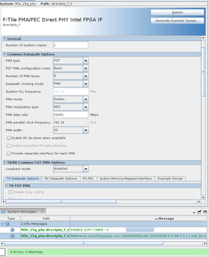

3 years agoAgilex Ftile is not asserting tx_ready after the reset sequence (tx_rreset/tx_reset_ack)
I build my controller model to Agilex F-tile transceiver. Please see the configuration below for F-tile and simulation waveform. Xcvr is asserting tx_reset/tx_reset_ack and rx_reset/rx_r...

Thank you for your quick response. Yes, I fulfilled the reset sequence that was described in 6.7. I am getting tx_reset_ack/rx_reset_ack, tx_pll_locked and rx_is_lockedtoref but not tx_ready/rx_ready. that I mentioned before.
I also noticed that when tx_pll_locked is asserted, tx_clkout2 stop toggling. Please look at the at the waveform again, the run-time reset sequence is following as indicated in 3.8.8 except asserting tx_ready/rx_ready
I am using Questasim simulator. I am using FAST_SIM directive. Please let me know, if I am missing something.
