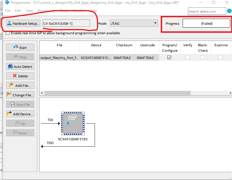

I am not able to program my Cyclon V EVM as the Quartus prime (Quartus prime version 19.1.0 build 670 09/22/2019 SJ Lite Edition) because USB blaster II is not being detected by Quartus programmer.
This seems like a road block as I am not able to flash .sof file for testing.
Ideally hardware setup should be "USB-Blaster [USB-1]" but it is showing "CV SoCKit [USB-1]"

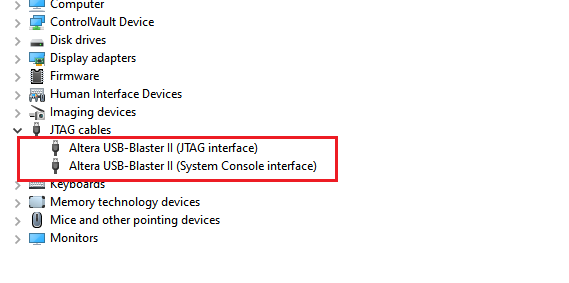

Device manager is recognizing the device properly.

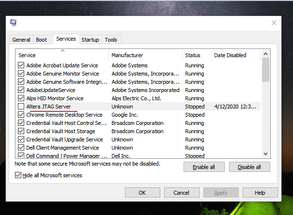

Then I found a link from Intel FAQ link (added below) requesting me to disable"Altera JTAG server" from the services. I did that as well but still no luck.
https://www.intel.com/content/www/us/en/programmable/support/support-resources/knowledge-base/solutions/why-is-altera-usb-blaster-not-detected-by-quartus-programmer-whe.html

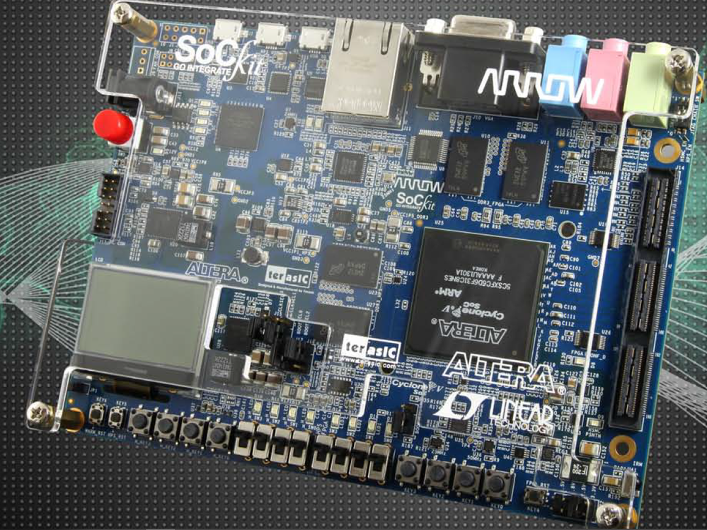

the EVM Kit is from teraASIL Cuclone V SOC kit.
https://www.terasic.com.tw/cgi-bin/page/archive.pl?Language=English&CategoryNo=167&No=816&PartNo=1

Welcome to INTEL forum. Could you help try on this just reboot Altera JTAG server (not disable it)
• Goto Window task manager -> process -> look for jtagserver.exe and kill it
• After that, the default JTAG clock frequency is 24M. Could you try reducing the JTAG clock speed to 16M or 6M to see how things go.
