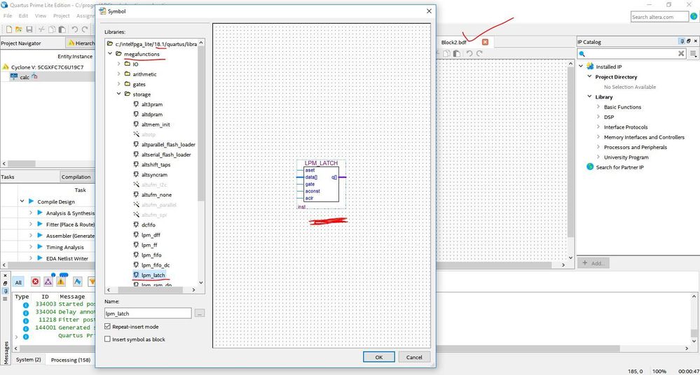

Check under "Symbol Tool" -> "Megafunctions" -> "Storage" for Block Diagram/Schematic File.
Refer the below screenshot,
Vikas

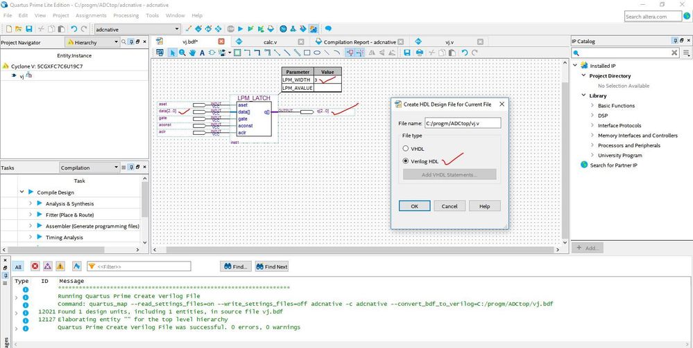

But How can I use it by verilog?
- Vicky1
- Open the .bdf file( already inserted the LPM_LATCH & edited the width parameter refer the screenshot)
- "File"->"Create & Update"->"Create HDL design file from current file.."
- check the .v file
let me know if this has helped to resolve your issue.

Thanks for the quick reply .It have resolved my issue.
