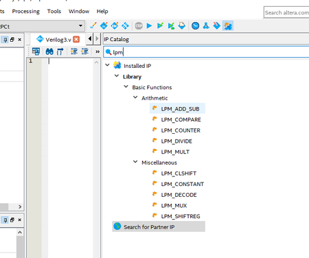

7 years agowhy I can't find lpm_latch in quartus 18?
There is many lpm like bustri I can't find
Vicky1
7 years agoHi,
- Open the .bdf file( already inserted the LPM_LATCH & edited the width parameter refer the screenshot)
- "File"->"Create & Update"->"Create HDL design file from current file.."
- check the .v file
let me know if this has helped to resolve your issue.
Regards.
Vikas
- zyun017 years ago
Thanks for the quick reply .It have resolved my issue.
