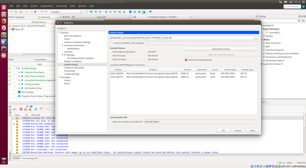

I've now tried to use this in Quartus 18 (having made a new NIOS "Gen2" component) and I'm getting the following error:-
Warning (292015): License for core Nios II Processor (6AF7_00A2), version 2009.04 is expired.
I've attached a screenshot of the license setup.
Can anyone explain the difference between the NIOS license being "permanent" but the "Subscription Expiration" being 2018.09?
Has my "permanent" NIOS license *actually* expired?
Or does my previous license not support the Gen2 core?
Cheers
Mark J.

Hi Got your license.dat attachment. There are 2 version of Nios in your license.dat. 1) FEATURE 6AF8_00A2 alterad 2008.10 permanent uncounted and 2) FEATURE 6AF7_00A2 alterad 9999.12 16-mar-2012. The no2 license is the evaluation license and supported until Quartus 11.1.That explain why Quartus 11 was supported. For your question Has my "permanent" NIOS license *actually* expired? Your license is still permanent, and you can use anytime with version 11.1 and below. Regrettably, your license will not support Quartus 18. - MJack11

Hello Based on my understanding for the first license, yes, it is a permanent license file. (FEATURE 6AF8_00A2 alterad 2008.10 permanent uncounted) mean that your license is permanent at 2008.10. Your license supported Quartus that release until 2008 permanently, that is Quartus version 8.0 and below. By right your license support only covers the NIOS Gen1 "classic" core and you will need a valid license for Quartus 18. Kindly contact your nearest Altera sales person or distributor to purchase a valid license file. To order by phone: In the United States and Canada, call Telesales at 1-888-800-0631. Outside the United States or Canada, contact your local sales representative or distributor. https://www.intel.com/content/www/us/en/partner/where-to-buy/overview.html buy online. https://www.altera.com/buy/design-software.html - MJack11
