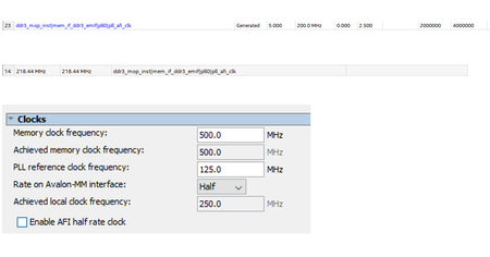

When using the "DDR3 SDRAM Controller with UniPHY" why does the generated .sdc specify the DDR3_ck and afi_clk at 80% of their specified rate from Qsys?

I can see you are using Half rate on Avalon-MM interface. For half rate, the maximum supported frequency for DDR3 is 400 MHz which means 500MHz is not supported for this type of interface. That's the reason you see below setting after compilation.
DDR3_CK: 400MHz
pll_afi_clk: 200MHz

Thank you for your response, I have overlooked that the max rate is 400MHz. Unfortunately, when I enter 400MHz into Quartus the Timequest Analyzer still exhibits the same behavior of showing the clock summary at 80% of the 400MHz.
DDR3_CK: 320MHz
AFI_CLK: 160MHz
This would still cause issues as the .sdc is specifying the AFI_CLK at a lower frequency so the logic is not being optimized to run at the correct frequency. What is causing this discrepancy?
