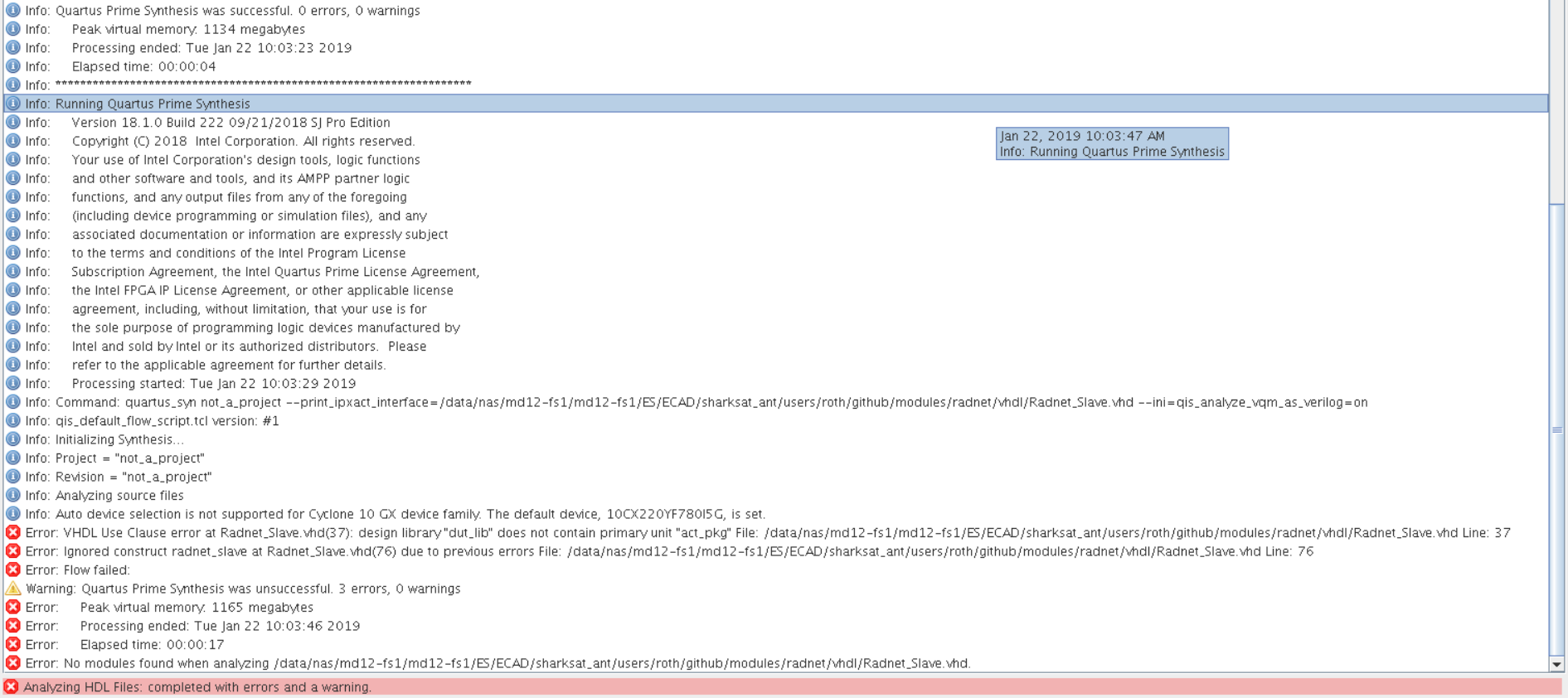

Hi I am having an issue with package files in Platform Designer (Quartus 18.1). I am trying to create a new component in PD. My design consists of a number of vhdl files plus vhdl package files. I loaded all the files, including the package files, then ran "Analyze HDL Files". This produced the following error:
"Error: VHDL Use Clause error at Radent_Slave.vhd(37)": design lirary "dut_lib" does not contain primary unit "act_pkg" File: ../../../vhdl/Radnet_Slave.vhd Line: 37"

    Correction: In order to debug the above error, I copied the contents of the vhdl package to the top of each module file. This worked fine after running "Analyze HDL Files".
    But when I tried to load all the vhdl files without copying the package info into each module file I got the error quoted above. Screen shot of the error is also included.
    Please advise how to use vhdl package files in Package Designer. Thank you!
