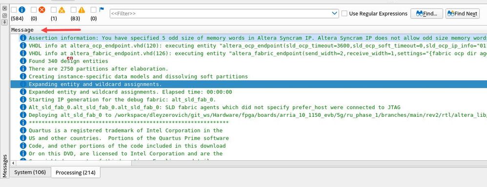

No, I'm looking for a text file with ALL the messages, which are displayed in the Message Window of the GUI (please see a screenshot in my previous message)

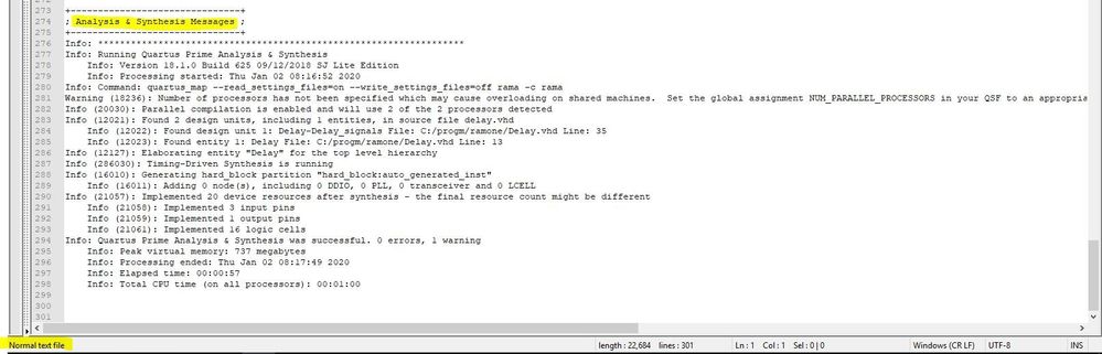

It`s text file only (*rpt) will generate in Quartus tool at different stages of compilation & simulation process. Please check each *rpt file at bottom you will find all the messages available in 'Messages' window, find the screenshot of *rpt file. If you want to do it manually you can copy & paste all the messages in text/word file.
