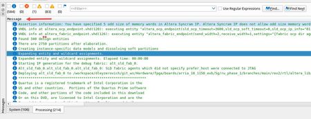

Hi All, What filename are the messages from the Quartus Project Compilation stored? Thank you!
