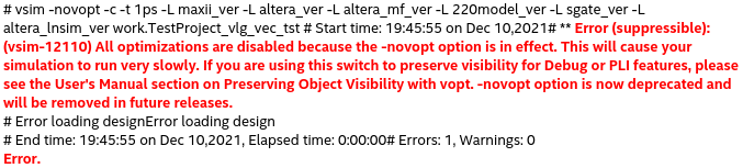

But when I do not remove -novopt this error happens:
I read somewhere that I should replace it with "+acc". but the result of functional simulation is still unknown.
