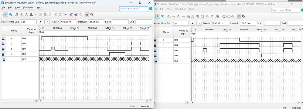

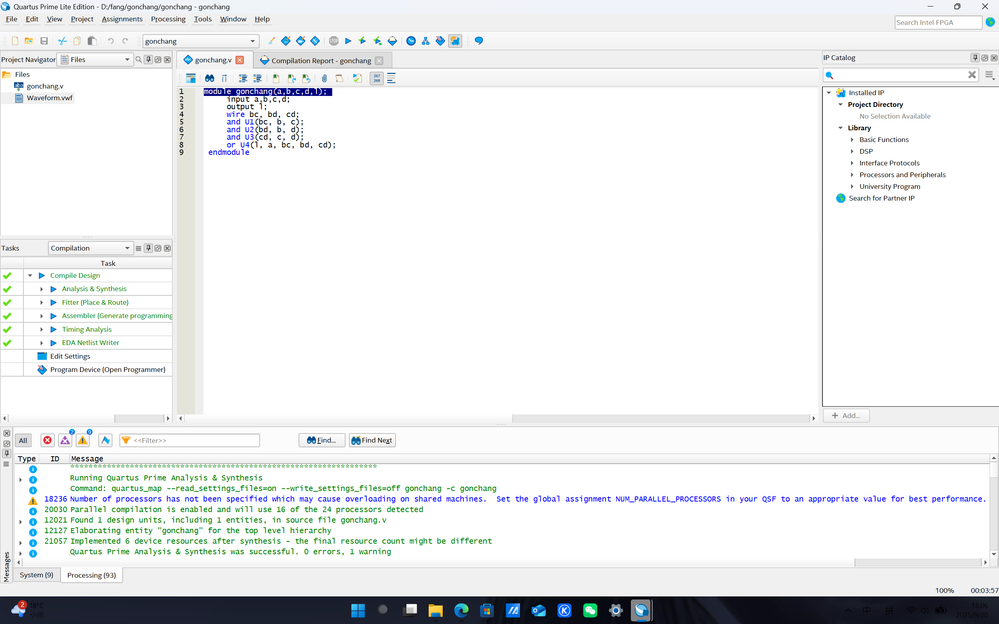

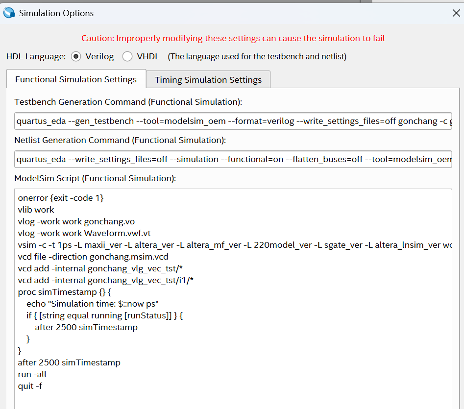

Hello, when I was simulating on Quartus Prime Lite, my project required using VWF to simulate waveforms, but I received an error vsim-12110. I have also searched for solutions, but the solutions suggest removing the -novopt text. However, when I used it, the simulation worked but produced a bad result where the output equals the input, which prevents me from simulating. Additionally, all the solutions from the forums have been ineffective.

    Unfortunately, the VWF simulation tool is a legacy feature used in Quartus Lite/Standard editions, and there are no plans to fix issues related to it.
    If it works for your design, then you're in good shape.
    If not, I recommend simulating using the Questa Altera FPGA Starter Edition simulator tool. I tested your design in Questa, and the waveform was correctly reflected.
    Additionally, you can use the NativeLink Simulation to automatically compile your design, Intel IP, simulation model libraries and testbench.
    Questa Altera FPGA Edition Simulation Flow
    Lite/Standard Edition:
    https://www.intel.com/content/www/us/en/docs/programmable/703090/21-1/simulation-quick-start.html
    1.8. Using NativeLink Simulation ( Intel® Quartus® Prime Standard Edition):
    https://www.intel.com/content/www/us/en/docs/programmable/683080/23-1/using-nativelink-simulation.html
