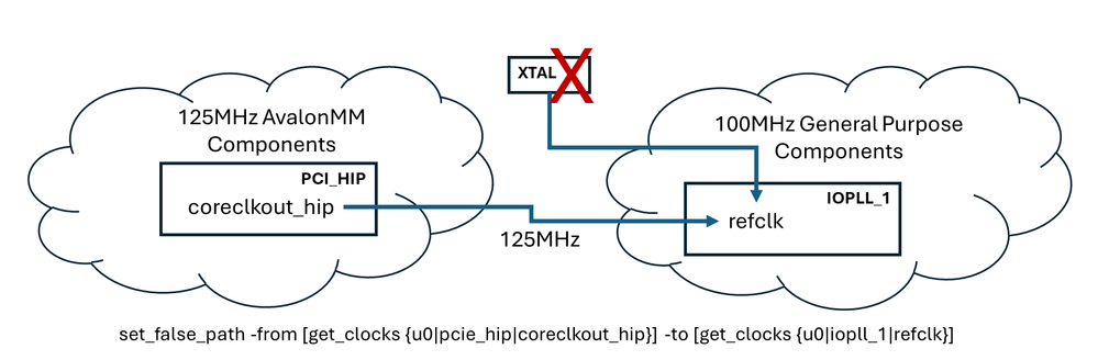

Using PCIe HIP core clock out to drive IOPLL reference clock -- advise on set_false_path syntax
Hi Need advise on suitable set_false_path design constraint construction for the following scenario where PCIE HIP core clock out is used as the reference for an IOPLL instance: Impact of doi...

    Hi FvM
    So it seems when the base/parent clock for the 100MHz domain was the external crystal Quartus was treating it as an unrelated clock hence no timing failures and status/control bits between the clock domains have synchroniser depth of 2 -- when PCIe core clock out was substituted for the external crystal -- Quartus started treating both clocks as related even though decoupled using an IOPLL instance -- the following design constraints appear to correct the situation
    set_false_path -from [get_clocks {u0|pcie_hip|coreclkout}] -to [get_clocks {u0|iopll_1|*}]
    set_false_path -from [get_clocks {u0|iopll_1|*}] -to [get_clocks {u0|pcie_hip|coreclkout}]
