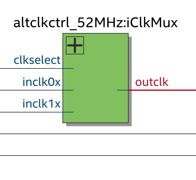

So this is the RTL view of the new ALTCLKCTRL block that I have put in. I made sure the two inclk pins only go to this block. clkselect is coming from a programmable register inside our Avalon Design so I know it is functional.
This is the MAPPED view, notice that the two clocks: clkin_50_bot and hsma_clk_in0 are now disconnected?
