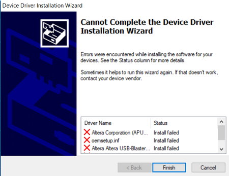

I had been using Quartus Prime Pro 18.0 successfully with my Stratix 10 SoC development board on a Windows 10 machine. I upgraded to 19.1, and I can no longer program the FPGA. I did the same on a co...

Hi Paul,
Seems like there is a problem with USB Blaster on 19.1. Can you try to apply the patch available at link below:
https://www.intel.com/content/altera-www/global/en_us/index/support/support-resources/knowledge-base/component/2019/why-does-my-usb-blaster-ii-not-work-when-using-intel--quartus---.html
Sorry for any inconvenient caused.
YL
