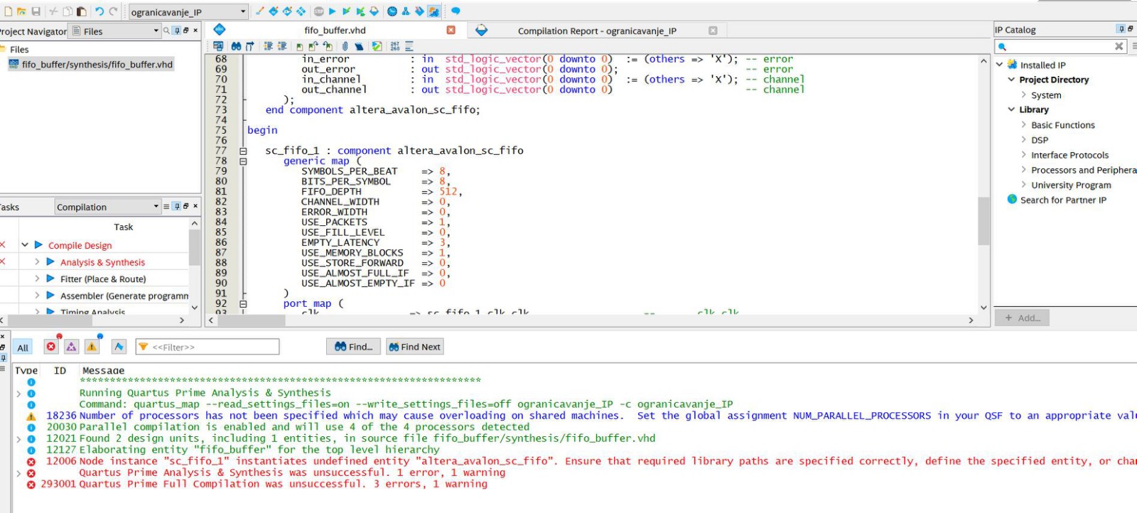

Undefined entity "altera_avalon_sc_fifo". Ensure that required library paths are specified correctly
Hi there.
I have a problem using Platform designer ( Quartus Prime Lite Edition 19.1 ) to get component of altera_avalon_sc_fifo buffer-a. When I export all signals ( delete clock of platform designer, I need buffer as component), and generate VHDL code, I get error after compiling synthesis file of buffer.
I can't find library that includes altera_avalon_sc_fifo ( keep in mind 19.1 Lite edition ). I will attach image of error and .vhd file which i get from Platform designer generate option.
Thank you in forward.
- sstrell
It's not clear what you are trying to do here. Are you trying to synthesize a component that's not connected to anything by just having the HDL file as the only file in a Quartus project? That's not going to work. What's your goal?
- Nurina
You are suppose to manually add the .qip and .sip files to your project after generating the IP core. Did you do this?
