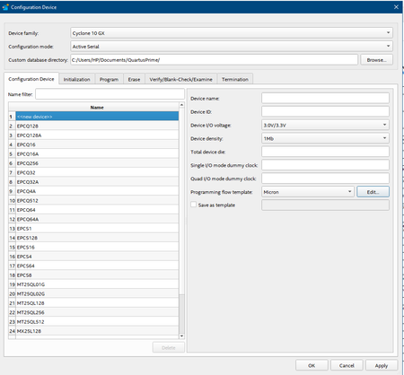

Unavailable to Create CvP File at Convert Programming File at Intel Quartus Prime Pro 19.3 version

1st question on selecting EPCQL device for Cyclone 10 GX FPGA. This looks like a bug on Quartus 19.3 Pro Edition. This issue will be fixed in the next Quartus released. You can either select EPCQL with Arria 10 as the device or use Quartus 19.2.
For 2nd Question related to generating split perphi.jic and rbf file, you will need to add the sof file which has the the CvP initialization enabled before the "Create CvP File" is available to be enabled. This is to protect from accidentally enable and Quartus convert programming file generate error when user tried to convert it even if the sof file does not have CvP initialization enabled. Please let me know if you are still seeing the issue after adding the sof file into the Convert Programming File GUI.

even adding the .sof file the error persists
