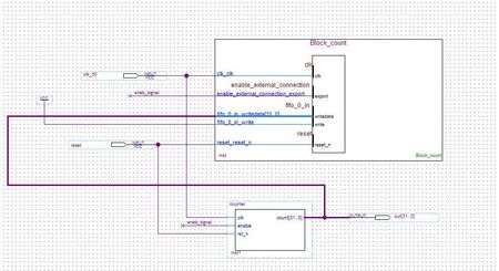

8 years agoUnable to read the data from AVALON FIFO MEMORY under on-chip memory
I want to write 32-bit data into FIFO and read that data from FIFO. [FIFO configuration :Aalon-MM write slave to Avalon-MM read slave.] I have tried the below design but data is not in proper seque...

8 years agoYou write to the fifo faster than you read back from it, so you will miss a lot of the counter values. In your design the write signal is always 1, meaning you write a value on each clock cycle. On the other side, as you are using a CPU to read back the data, there will be multiple clock cycles between two reads.
