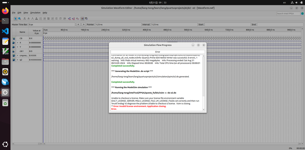

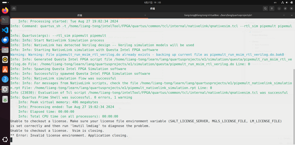

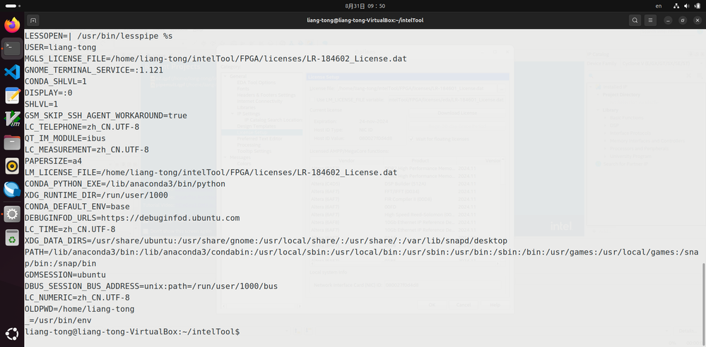

When I try to run RTL simulation. There is error message shown, Unable to checkout license. ……. The detail message is shown in the attached files.Quasta read the right dat filevsim report error about the licansethe file heresystem env report

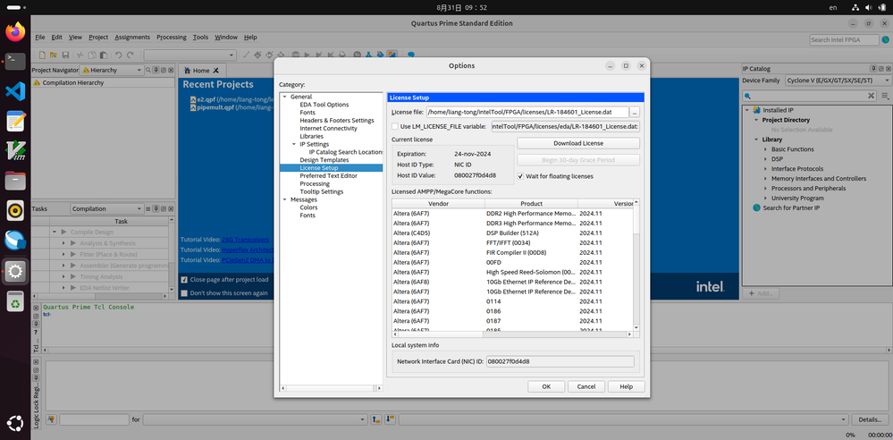

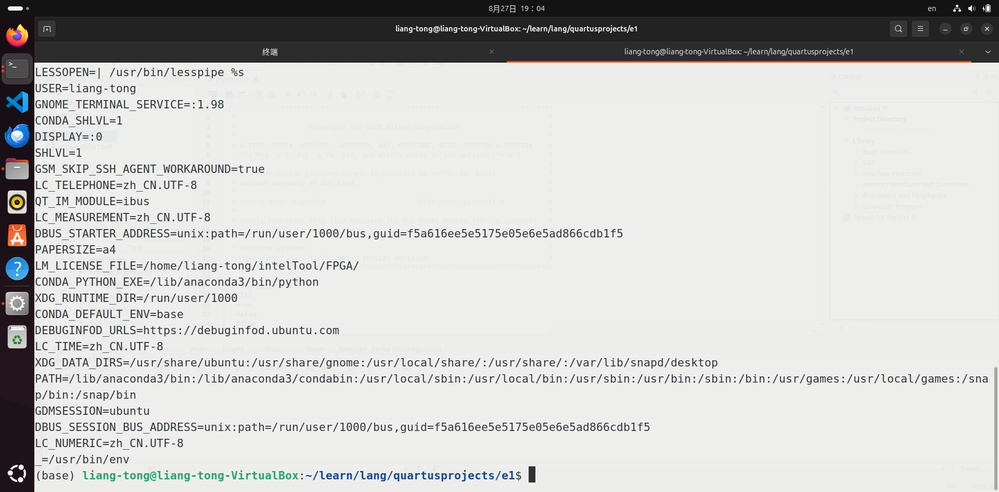

I run quasta on the Ubunto. I have set LM_LICENSE_FILE paramter in the profile. Please check the picture attached.

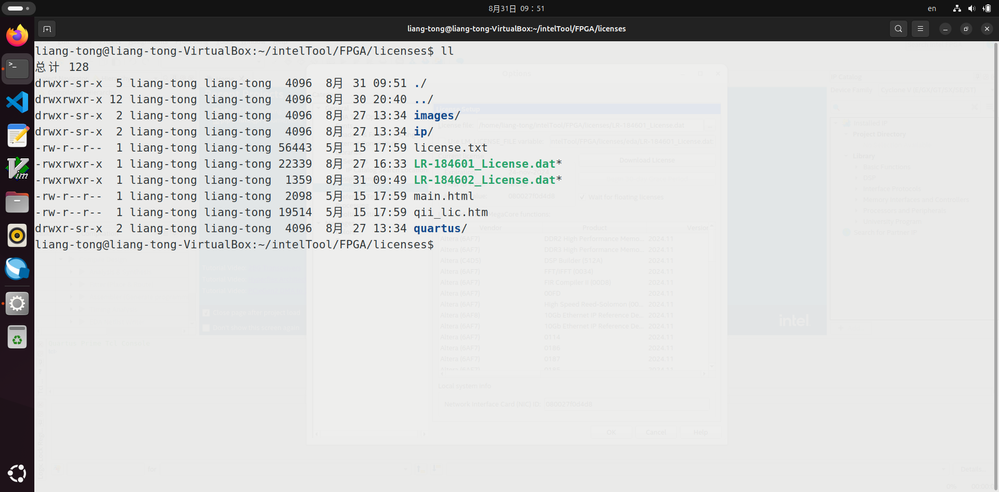

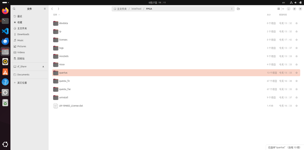

Either Questa doesn't like the dash ("-") in your path or it's the fact you're missing "licenses" in your LM_LICENSE_FILE variable.
Strangely, you have /licenses in the path in Quartus but the file is placed one level higher in /FPGA. Do you have an old file lingering around?

Like I said, try fixing your path:
LM_LICENSE_FILE=/home/liang-tong/intelTool/FPGA/licenses/LR-184601_License.dat

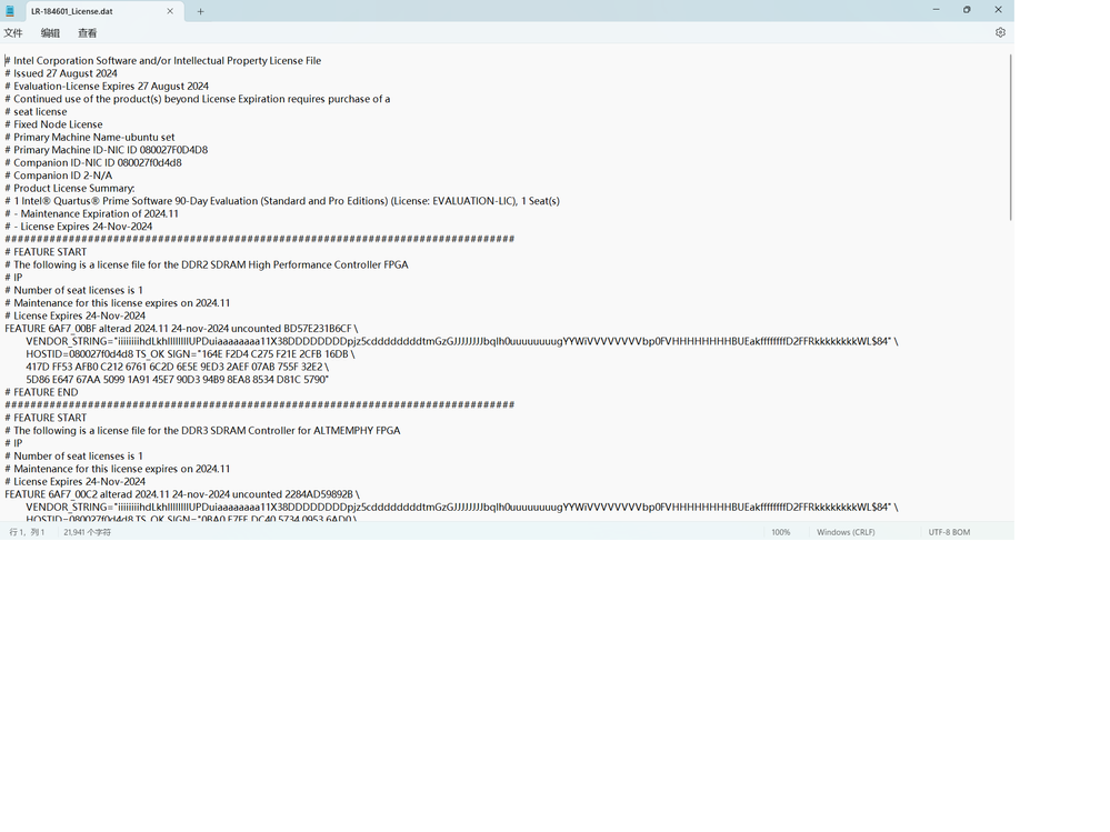

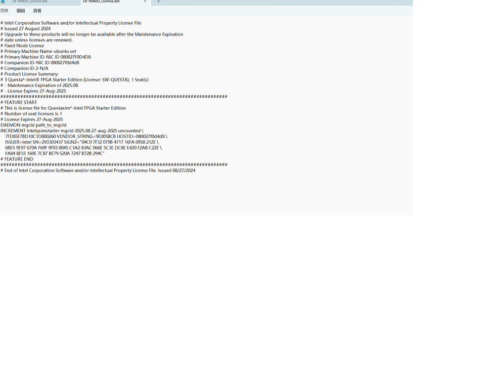

I forgot to attach the licenses files. They are here this time.

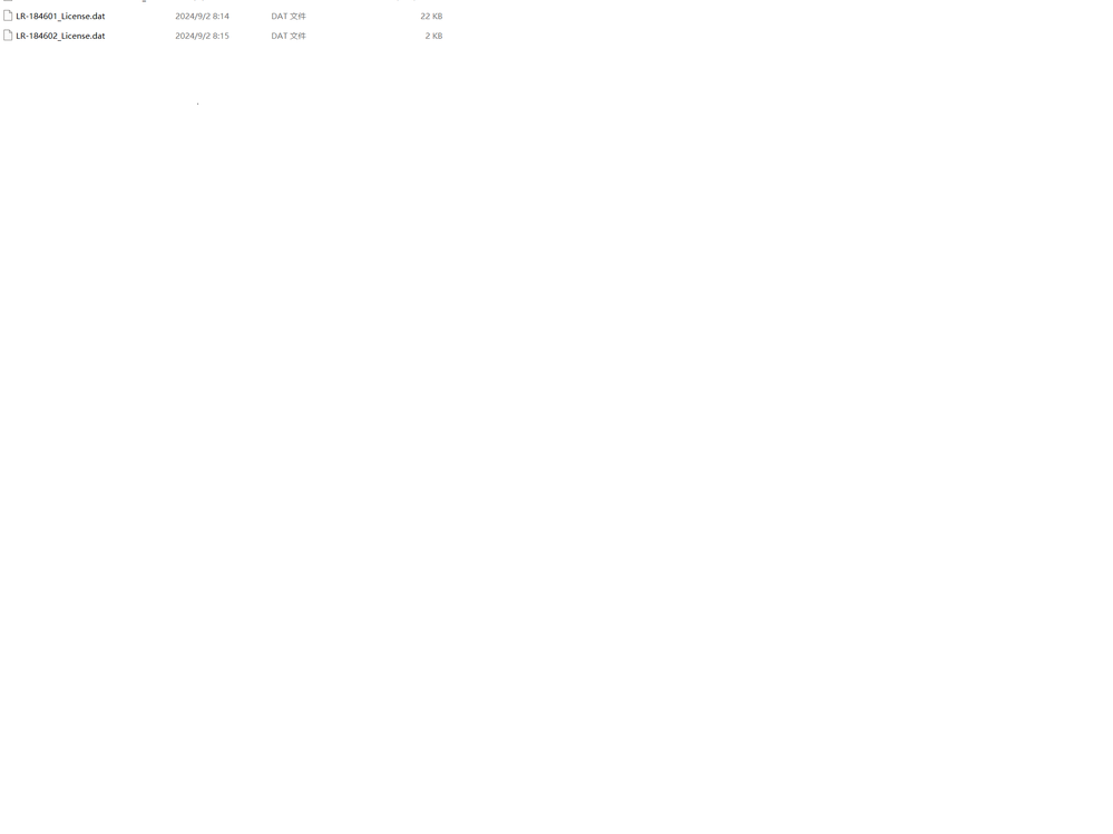

- iamtongliang

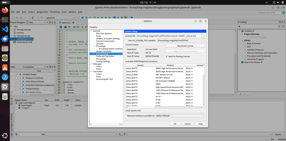

Dear Sir:
I try to do as your idea. But it doesn't work. The message prompted is still same as before.
I have 2 files about the license. Both of them are dilivered by the intel via email. Please check the capture pictures below about them.
Please tell me how to save them and config the enviorment.

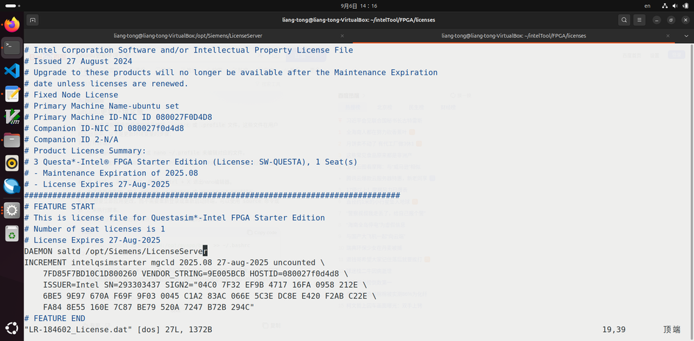

Welcome to Intel forum. It appears that the version of Questa included in 24.2 is no longer compatible with the old FlexLM daemon. To resolve this issue, upgrade to the Siemens FlexLM (SALTD) daemon v11.19.5.
In Siemens License version v11.19.5.0, there's a change that requires action if you're running a floating license server. You need to manually update the VENDOR daemon line in your license file from mgcld to saltd. For example: VENDOR saltd <path to saltd>.
The KDB is online here
https://www.intel.com/content/www/us/en/support/programmable/articles/000099465.html

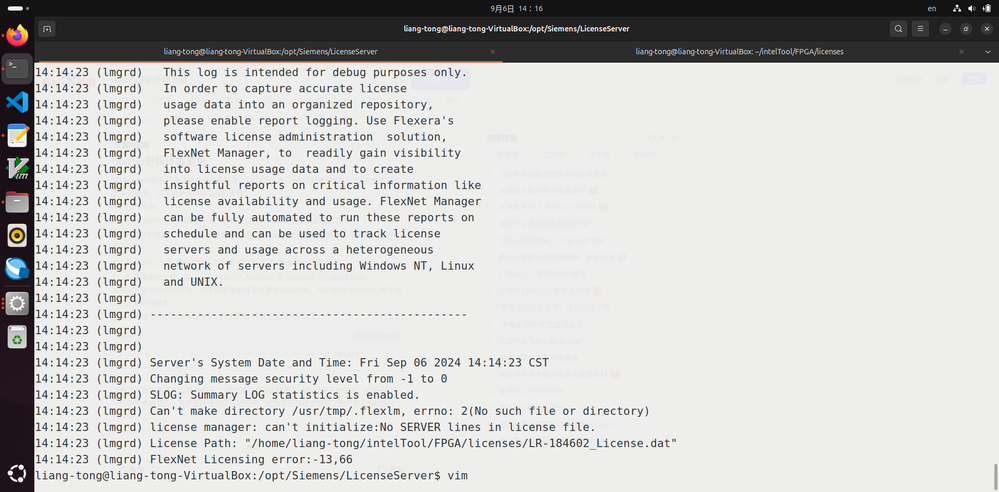

- iamtongliang

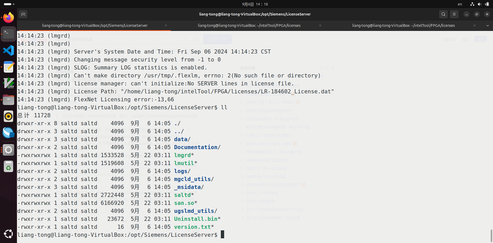

Dear Sir:
Thanks for your reply.
I follow your suggestion and download the package and install it. But the result isn't OK.
Please check the pictures.
Please tell me how to do next.
Thanks a lot.
