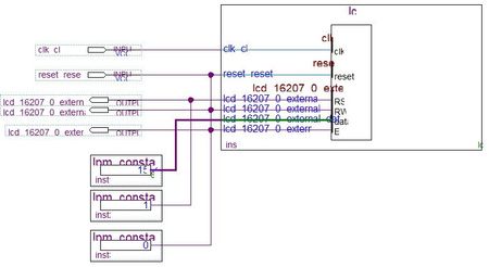

8 years agoTo display some characters or decimal values in Character LCD Display for Cyclone III (EP3C120F780C7) board, am i doing correctly or not. Please suggest the correct thing to me... i am not getting the value in LCD display

8 years agoHi,
Have you tested your design using simulation?
- If not, first create an instance for your design & write test bench for that or you can simulate using NativeLink.
- while implementing this design on board you need to adjust the clock frequency so that you can see result on display.
Best Regards
