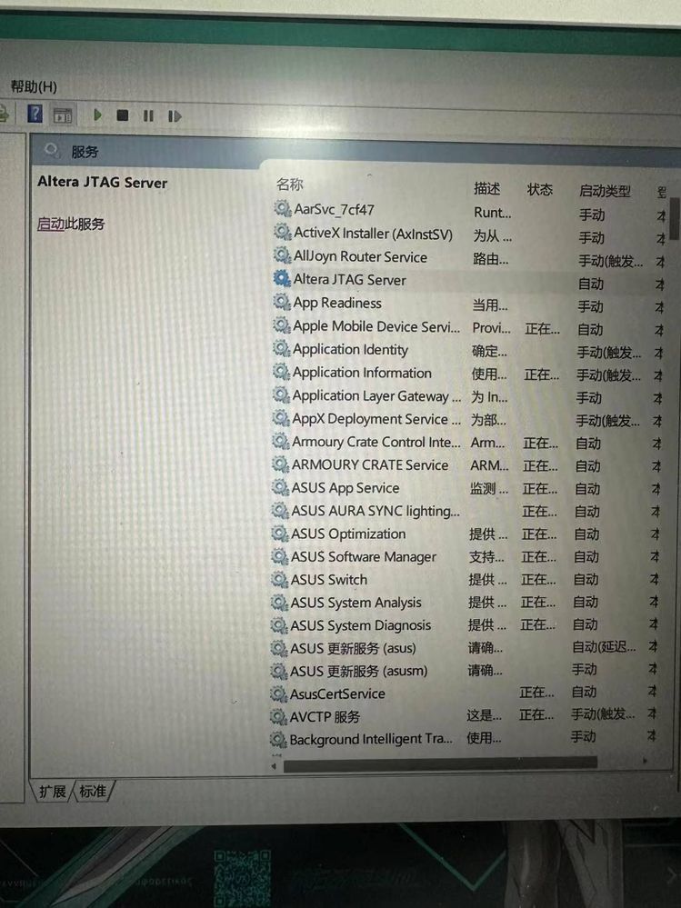

The Altera JTAG Server service is missing from the computer
A few days ago, the Altera JTAG Server service was suspended in the computer management, and the service could not be started after restarting the error, and the service disappeared after restarting the computer.I don't know how to get it back, otherwise the programs in Quartus2 won't be downloaded to the board.Hope to get your replies.

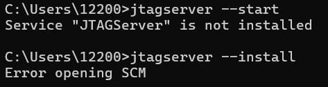

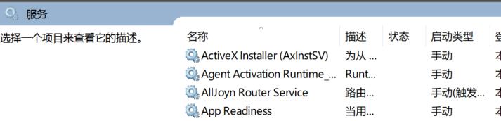

    • 孙楚悦's avatar
      孙楚悦
      Thank you for your answer. I have tried to reinstall this service according to the instructions you gave, but it still doesn't work
    • 孙楚悦's avatar
      孙楚悦
      Thank you for your answer,sorry to keep u waiting for so long.Actually,I have further questions. I have tried to reinstall this service according to the instructions you gave, but it still doesn't work.

    • 孙楚悦's avatar
      孙楚悦
      Thank you for your answer,sorry to keep you waiting for so long.Actually,I have further questions. I have tried to reinstall this service according to the instructions you gave, but it still doesn't work.
