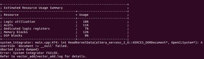

system_integrator : core dumped
I'm currently following the beginner's guide for intel FPGA on linux host (https://www.youtube.com/watch?v=npeuaj-mfvy&t=2s) but I'm stuck during the compilation process of the device with a corre dumped. The command is :aoc device/vector_add.cl -o bin/vector_add.aocx --report --board c5soc_sharedonly Here's the problem : http://www.alteraforum.com/forum/attachment.php?attachmentid=13170&stc=1 The log file shows the same thing. Have you got any clue on how to solve this problem ? Thanks.7 Replies

Please post the following info:
1- Output of "aoc --version" 2- Version of vector_add example you are using 3- Operating System and amount of memory installed on the machine on which you are compiling the kernel - Altera_Forum
Honored Contributor
1)
2) exm_opencl_vector_add_arm32_linux.tgz V16.1 3) Ubuntu 16.04.1 LTS with 30Go and 7.5 Go freeIntel(R) FPGA SDK for OpenCL(TM), 64-Bit Offline Compiler Version 16.1.0 Build 196 Copyright (C) 2016 Intel Corporation - Altera_Forum
Honored Contributor
Please install update v16.1.1 for both Quartus and AOC and see if it fixes the problem; v16.1.0 has issues with OpenCL compilation.
- Altera_Forum
Honored Contributor
unfortunatly this do not solve the issue ...
- Altera_Forum
Honored Contributor
Can you post the "quartus_sh_compile.log" file? Also retry "aoc --version" and make sure the update has been installed correctly.
- Altera_Forum
Honored Contributor
Here is the aoc version Intel(R) FPGA SDK for OpenCL(TM), 64-Bit Offline Compiler Version 16.1.1 Build 200 Copyright (C) 2016 Intel Corporation and the file is attached - Altera_Forum
Honored Contributor
Actually the kernel log is not very helpful in debugging such issues, that is why I asked for the "quartus_sh_compile.log" file. Though you might not have that log at all since it seems your compilation is crashing in the OpenCL to HDL conversion phase. If you have the quartus_sh_compile.log file, please post that, if not, your problem might be a permission issue. Try switching to the root user and running everything as root.
