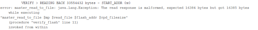

System_Console.exe - [USB MASTER] master_read_to_file: java.lang.Exception:
We have Custom HW where maximum of the design is leveraged from Max-10 Dev Kit Rev C.
Here we are using the System-Console - USB Direct interface as a Master to Transfer a file or readback to file from HOST system to Target SPI flash (Generic Quad SPI flash controller) using a customizable_programmer.tcl script
After many successful runs, suddenly we see a error on System Console
"master_read_to_file: java.lang.Exception: The read response is malformed, expected 16384 bytes but got 16385 bytes"
Please help!

  • rtalluri's avatar
    rtalluri
    Yes, we see that master_write_from_file throws up this error say after 100's of successful transfers and no changes were made to script
    we are using "Quartus 18.1 Standard Edition Build 625"
