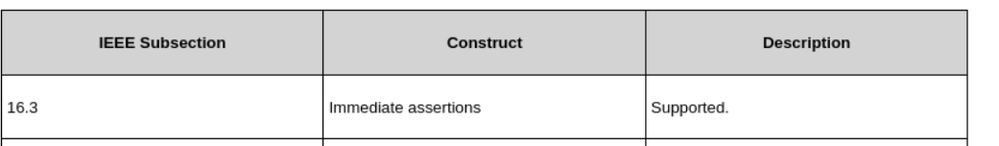

I have enable the asseriotion, under assignements->settings->compiler settings-> advanced options.
when i run the above code i dont see any error message.
and i see assertion is supported
am I missing something, while using assertion?

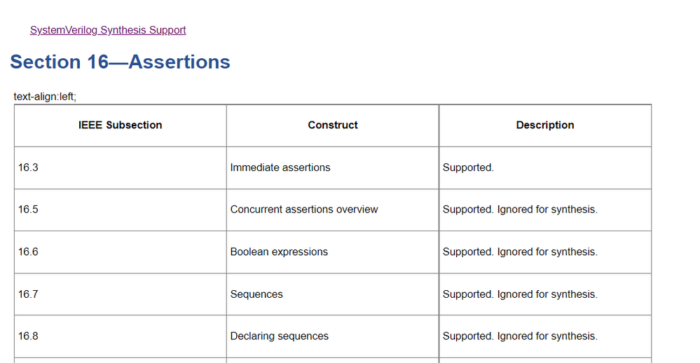

- vraj12
In the snippet it is mentioned as supported and it does not say ignored by synthesis, was expecting it prints out the message in log.
Immediate assertion is similar to if statements, so was expecting some logic is generated
- Nurina
If I'm not mistaken $error is from SystemVerilog-2005. This is only supported on Quartus Prime Pro.
