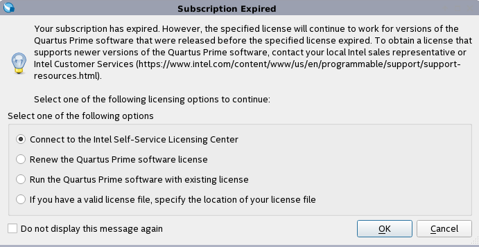

We have multiple versions of Quartus that we use, we have had Licenses that go back quite a few years, usually we just fill out the new one, put it into place and start the license manager.
But after this time, we do the same steps and yet it won't accept the license or look for it. We didn't install any newer version of Quartus on the server or anything that far, just update the license.
Currently we are running Quartus Prime Version 22.1.0 Build 174 03/30/2022 SC Pro Edition, which doesn't have the pop up, but when we run Quartus Prime Version 21.1.0 Build 842 10/21/2021 Standard Edition, it pops up saying the subscription has expired. The License server FLEXlm is v11.18.2 and so is alterad.
Why is this happening to the Standard versions and not the pro version when we have a standard license?

    Hello
    Welcome to INTEL forum. If you have a valid license, you could choose the last option. Select the specify license location and let us know how it goes.
