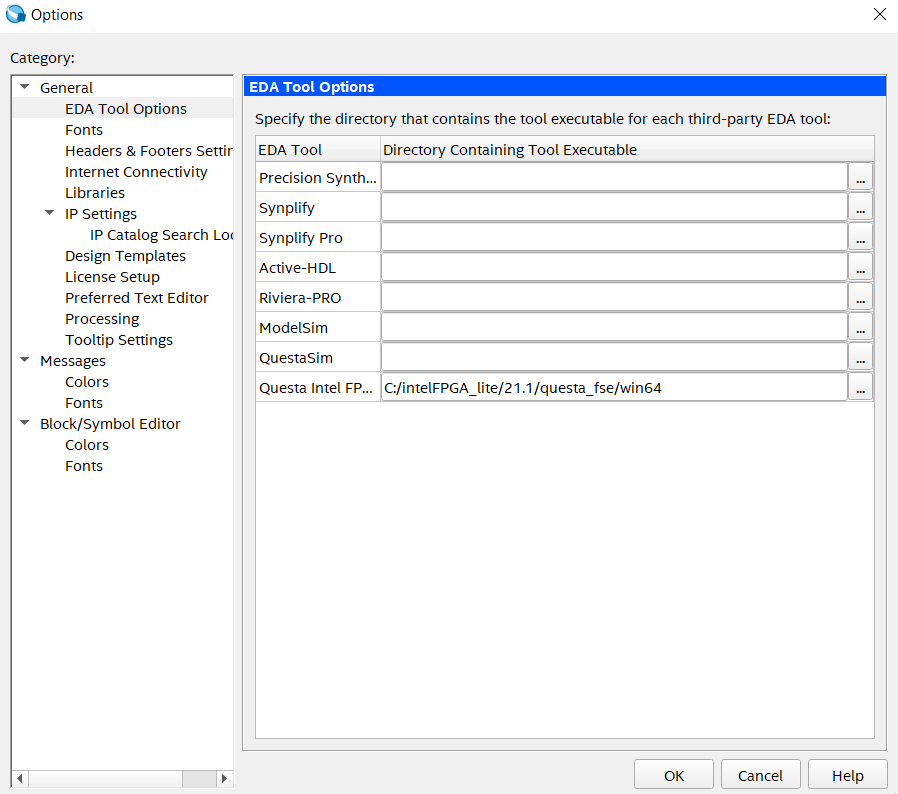

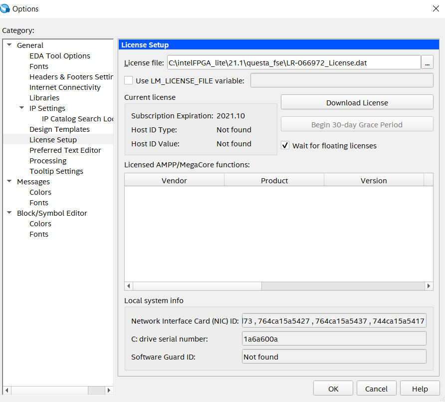

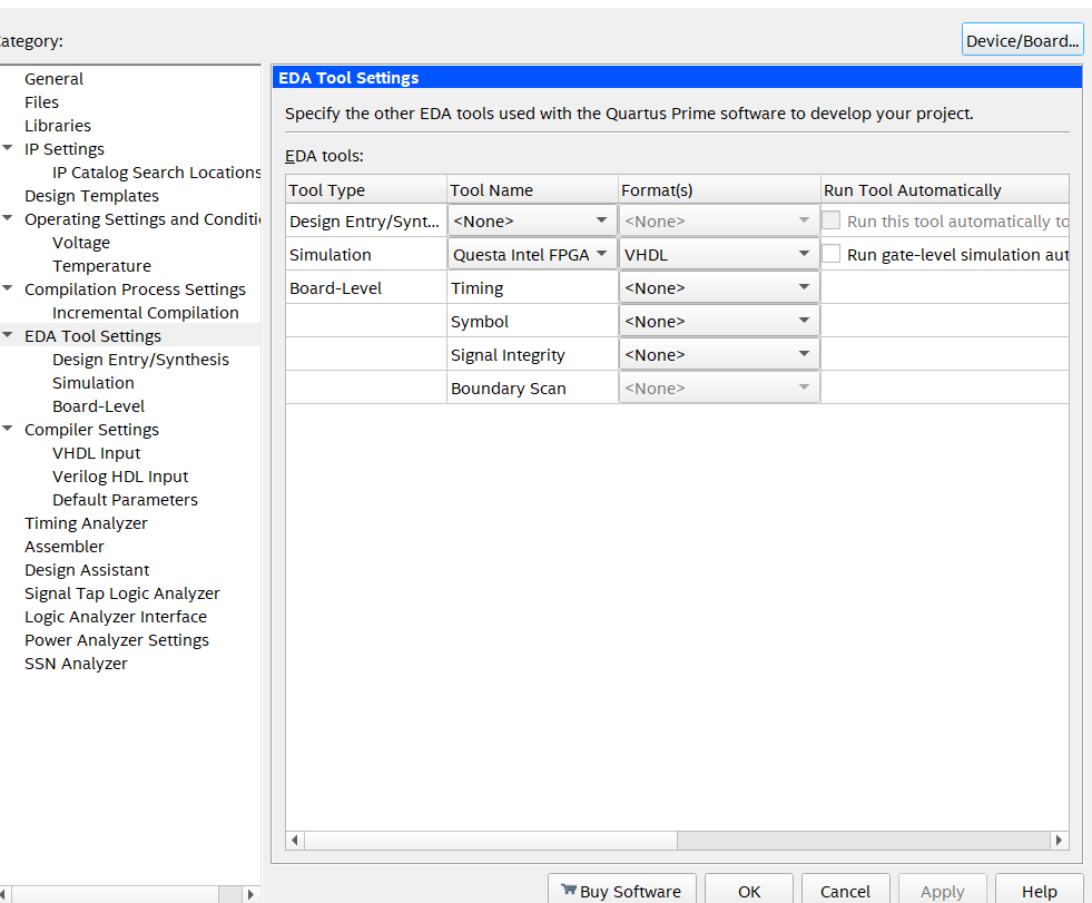

I have obtained a license for running QuestaSim and I think that I have filled the options/license and different configurations properly but I am still getting a license related error when launching the simulation. Did anyone come across the same issue?
a)License path setting

c)EDA Tool options config
d)Assignment EDA config:
