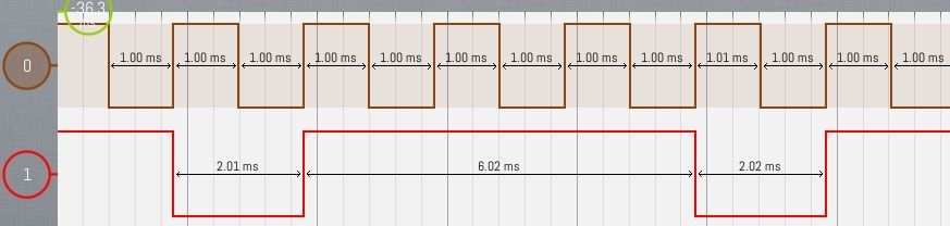

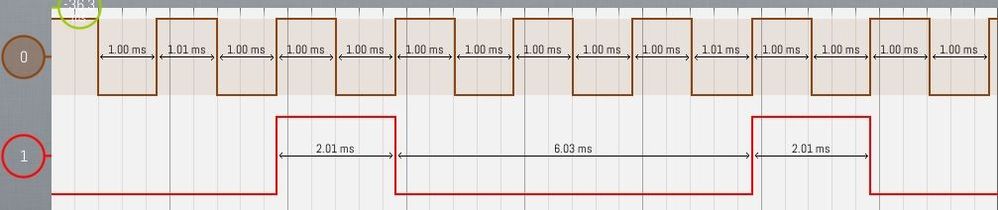

- GeraldLi1
your State Machine Wizard store level 0 between States but NOT level 1
I use Arduino Vigor board
See attached files & photos

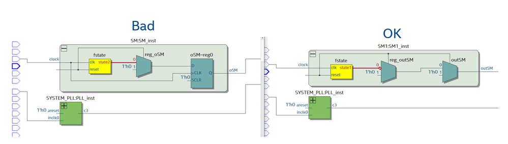

- RichardT_altera
Sorry for the delay in response.
I believe from design functionality, they are different.
You may check from the RTL viewer that both design function different. The SM output is from State 2 (bad) vs state 1 (OK).
My recommendation would be to simulate the design first in order to verify that you get the desired function.

- GeraldLi1
I have developped this Logic Analyzer based on Arduino Vidor WITHOUT Verilog knowledge !
https://gelit.ch/Vidor/LA_E.pdf
https://github.com/gelit/Logic-Analyzer-with-Arduino-Vidorit was possible because Intel Quartus Lite provides higher level abstraction with graphical tools like Block Diagram/Schematic & State Machine File
My proposal is to modify State Machie Wizard allowing user to edit only page 5 of https://gelit.ch/Vidor/LA_E.pdf
- every output will be initialized
- ONLY output change MUST BE WRITTENHave a good day / retired IT professor Gerald Litzistorf - https://gelit.ch/
