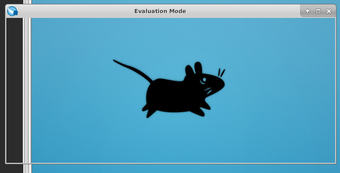

I installed 18.0 pro on two Ubuntu servers. When I try to access quartus through VNC viewer, on one server it simply fail to show the GUI, windows stuck there as shown below, the other one is OK, but it seems the key map is wrong, type qwertyuiopasdfghjkl;', it shows c.gvnmlzx afbhjk;'`i .

Switch vncserver to TIgerVNC, and everything works fine.
- FawazJ_Altera
This seems to be VNC issue, not Quartus.
Try the suggestion in this link:
https://ubuntuforums.org/showthread.php?t=1567679
