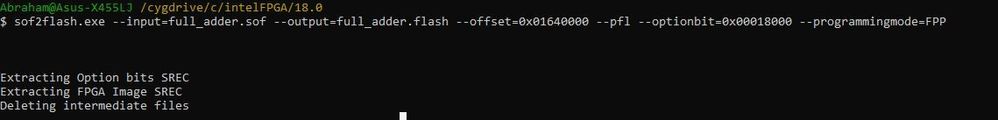

  • Well, I just checked the command from a Windows 10 NIOS-2 prompt and it works fine. Check that the SOF file has been generated using the latest 18.1 version of Quartus. This could happen if you're using an SOF created by an earlier version.
  • I don't have such issue in win10. ​Did you try any older Quartus version ,eg 18.0std or regenerate the .sof in the same version?

    Abe's answer worked, it turned out I was using a different version of NIOS than the version of Quartus I was using to compile.
