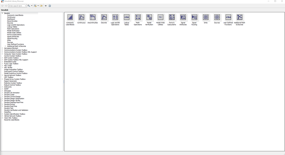

I meant that DSP Builder library is not displayed in Simulink Library Browser:
Is Matlab R2015a compatible with DSP Builder 22.4? Apparently it should be compatible according to DSP Builder Installing wizard.
After executing "DSP Builder - Start in MATLAB R2015a" (or "DSP Builder - Start in MATLAB R2022a") Matlab path is changed to "C:\intelFPGA_pro\22.4\quartus\dsp_builder". However, this directory is empty. All simulink files seem to be in "C:\intelFPGA_pro\22.4\quartus\dsbab". According to the thread https://community.intel.com/t5/FPGA-Intellectual-Property/DSP-Builder-Installation-Problem/m-p/69978, dsp_builder path should include BlockInfo.dll. Could this be the problem?

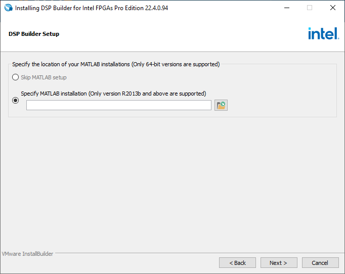

Issue was solved using DSP Builder 17.1 and Matlab R2015a. DSP Bulder v22.4 and Matlab R2022a compatibility was not tested again. In addition installation wizard information is confusing because it specifies that DSP Builder 22.4 is compatible with Matlab R2013b or above.
