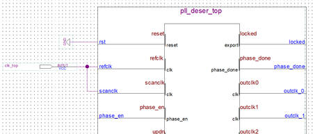

3 years agoSchematic Editor Problem Quartus 21.4
In the schematic editor the "pins" on the block symbols (generated by Quartus) don't line up with the grid points in the schematic editor. This makes it look like the interconnections are "skewed". ...

3 years agoGo to Project Navigator -> Files -> include .bsf file -> open to modify
Or try to reinstall Quartus, I'm not getting any issue on editing .bsf file in v21.4 window check image attached.
Let me know if you have any further concern or update.
