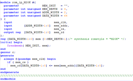

Hi All,
i am working on a project with Stratix 10 Device.
i have tried to implement System Verilog Rom (not as IP) in my design.
the problem is that some ROM's Quartus translate correctly as a ...

3 years agoLooking at a template in the text editor, there is no CS signal used. Also, why are you using a generate statement and a genvar that you are not using anywhere?
