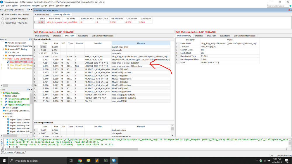

I'm trying to optimize a part of my design to meet my timing goal (150 MHz ~6.66ns path) but one register is not being read as a register on my timing analysis and I don't know why. In the timing analyzer it shows the register cell as a logical cell in the middle of the path, however, since it is a register, it should be at the end of the path.
My design has 2-stages (i.e. pipelined), at least it is supposed to be but the analyzer is not reading the variable as a register.
Here is the code snippet in question:

endHere is the critical path shown in timing analyzer:
Is there something I need to be doing in the timing analyzer for this to work? Any help is greatly appreciated, I've been stuck on this for a while and I've tried a bunch of things to synthesize a register but none of the I tried change the result of the timing analyzer.
