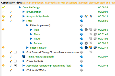

My understanding is that Fast Preservation option is for when you want to import the "static" design, but the tool unnecessarily spends time with compiling the static design.
