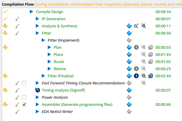

2) I ran the ANN899 experiment on my machine. The flat compile time on my machine is 20min and the fast reserve version is 8~9 min as shown below.

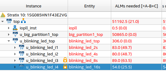

I think this is still too slow because u_bliking_led_i3 and u_bliking_led_i4 are toal less than 200 ALMs.
The Fitter-Finalize time itself is 2min 44seconds. Is this expected?

    2) That's still more than a 50% compile time reduction on a Stratix 10 compilation which can take many hours for a large design. The tool still has to analyze the entire design. It of course depends on how much of the design you are preserving. The more % of your design in the static region, the greater the savings.
