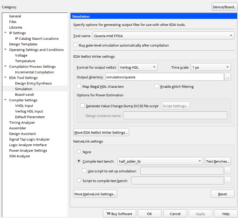

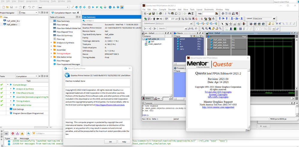

    I tested the nativelink without any problem check image below:
    Assignments -> Settings -> EDA Tool Settings -> Simulation (image below):
    Go to Tools -> Options -> EDA Tool Options -> Questa Intel FPGA and specify the paths:
    <quartus_installdir>/questa_fe/bin (Linux)
    <quartus_installdir>\questa_fe\win64 (Windows)
    Make sure using compatible Questa FPGA Edition. And also proper license setup check this link https://www.intel.com/content/www/us/en/docs/programmable/683472/22-4/and-software-license.html
