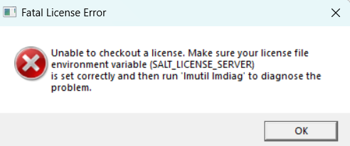

Hi when i try to launch questasim i obtain :
The SALT_LICENSE_SERVER variable is set :
and when i run lmutil lmdiag all seems fine :
what could be the problem ?
  • Hi,
    your enviroment variable is SALT_LICENSE_FILE, must be SALT_LICENSE_SERVER
    Frank

    This page needs some updating then: https://www.intel.com/content/www/us/en/docs/programmable/683472/25-3/and-software-license.html
    • RichardT_altera's avatar
      RichardT_altera
      I’ve provided feedback to the documentation team to correct the typo.
      Moving forward, users should use SALT_LICENSE_SERVER instead of SALT_LICENSE_FILE.
      Richard Tan
    Frank
    • ETang2's avatar
      ETang2
      Thank you very much.
      It works fine now.
