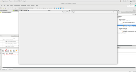

4 years agoQuartus Standard edition IP generation GUI blank
I tried to generate a PLL for our design in Intel Quartus Prime Standard Edition in both 19.1 and 21.1, but the GUI is just showing me blank. Attached is the snap shot of the same.
I a...

- VSavi34 years ago
Hi Richard,
I tried to invoke the quartus with root credentials.
It took me to license GUI, but as usual, the GUI content not displayed. Without GUI content I could not act further.
How can I get this GUI content properly displayed?
