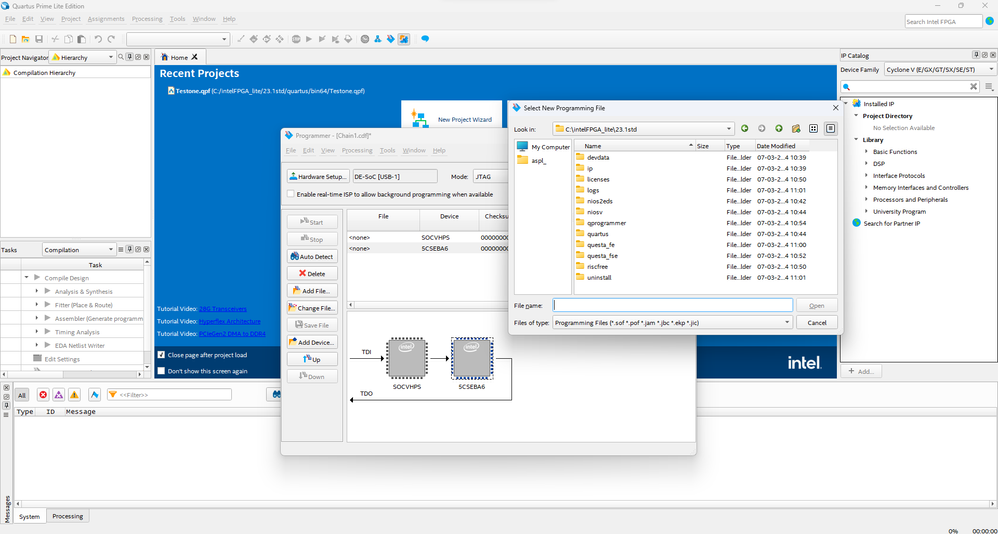

I am trying to configure DE10-Nano .
For that purpose, I am using Quartus prime software.
But in the attached image I couldn't see any .sof files available. Can you please suggest where the examples of FPGA(.sof) codes will be present in the Quartus software?

    You have to compile your design first. The Assembler then creates programming files like .sof in the output_files folder in your project directory.
