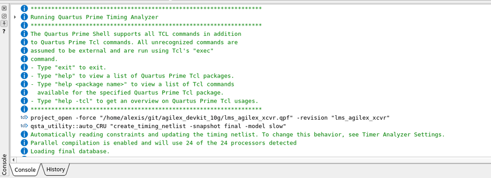

3 years agoQuartus Pro 22.4 Timing Analyzer: log file of the TCL console? How to search?
The TCL console of the Timing Analyzer has hundreds of lines.
I'd like to search for a word, the way we do in Xilinx/AMD Vivado.
I couldn't find the log file on the disk and CTRL-F doesn't do anything.
Search feature, very simple. How can I do it?
The log file is .sta.rpt located in output_files folder. In the log, search for Timing Analyzer Messages, those are Timing Analyzer TCL console messages.

- ShengN_altera
