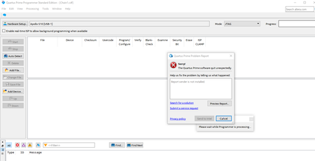

3 years agoquartus prime programmer tool crashes when uploading sof file.
I have an issue with quartus prime programmer tool. When I try to upload .sof file of Startix 10 (Apollo S10 platform), it crashes immediately. Moreover, it also doesn’t recognize the device when I p...
- 3 years ago
I was using Quartus prime standard version. Then I tried Quartus Prime Pro latest version and it works fine when programming Stratix 10.
The issue is resolved.

3 years agoYou should probably try reinstalling the Programmer and/or the drivers.
