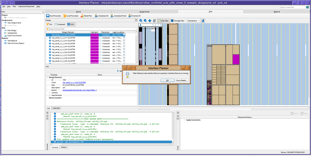

quartus prime pro 20.3 Interface planner crashes
quartus prime pro 20.3.0 build 158 09/24/2020 SC Pro Edition
Host Server info : Linux plxc25098 3.0.101-108.87-default #1 SMP Fri Feb 22 16:42:57 UTC 2019 (10e85a8) x86_64 x86_64 x86_64 GNU/Linux
Cannot move p-tile pcie gen 4 2x8 example design location from default p-tile 1 to p-tile 2

    Hi Lorne,
    Can you try to click on the show report and paste it here, probably there are some useful insights can get from there.

    I know this is old but I'm still seeing issues with interface planner in Quartus 22.3 crash when trying to place serdes/GXB. This is on any Stratix 10 design. I've cut and pasted debug info below but I'm going to hazard a guess that gui windows only really work in Microsoft window and it struggles with Linux based systems for something in the planner.
    I'll initiate a new case on premire support if that is better.
