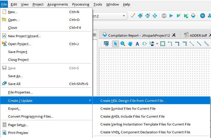

the problem might be that ModelSim doesn't support .bdf files. Quartus can convert it to HDL.
Frank - RichardT_altera
The simulator tool Modelsim or Questa has no concept of schematics so convert the bdf file to HDL language is preferred, as mentioned by FvM
