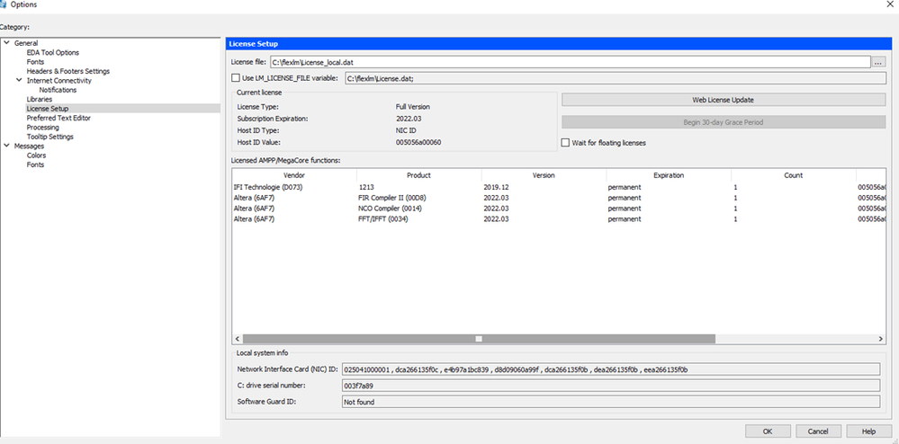

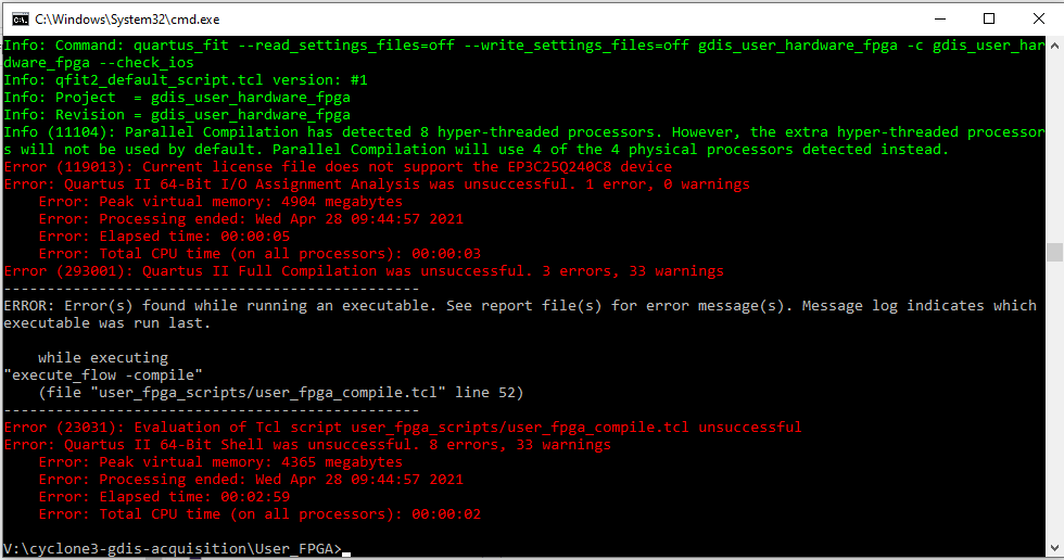

Floating license issues aside, due to tryiug different methods, when rehosting the license on my PC and running it I get what seems to be reasonable acqusition, however, when building the FPGA I get the error below which indicates that I dont have the Cyclone III device license. We already paid around £5000 to get the license, we are using Quartus II 13.1 because that is the latest supporting Cyclone III. It is hard to image why we are not getting what we paid for

When refer to the file attached, this error might be occur when the ModelSim-Altera license daemon is out-of-date.
To get it fixed, you will need to upgrade the client PC daemon (mgcld) software to the newer version.
The new daemon software can be downloaded from the website.
