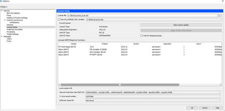

5 years agoQuartus II (13.1) Prime Pro license cannot be used after setting it on the server and locally
We have been trying to setup a network license on our internal server with the NIC. The server seems to be running fine from the logs. However, when trying to access from my side (using Quartus 13....

When refer to the file attached, this error might be occur when the ModelSim-Altera license daemon is out-of-date.
To get it fixed, you will need to upgrade the client PC daemon (mgcld) software to the newer version.
The new daemon software can be downloaded from the website.
