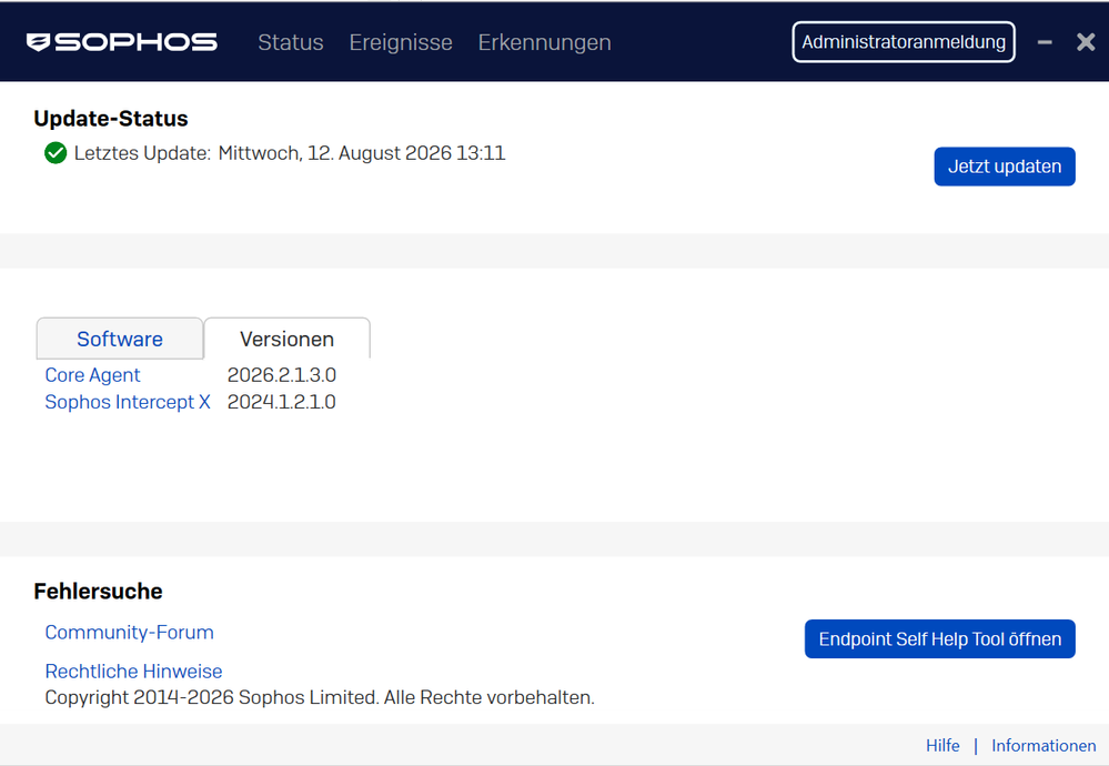

Hello KennyT,
Unfortunately, Quartus 26.1 still won't start for us when Sophos is enabled.
So the problem persists. Please see below Sophos version that is installed on my system.
Jens
