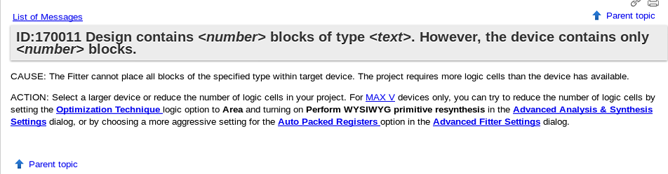

I have a design which compile and fit properly in Quartus_19.1.0.670 version.
But exactly same design does not fit when I use Quartus-21.1.0.842. It gave me following error.
I tried many settings in synthesis and fitter, but none worked for me. Any suggestions?

    How full was the device in 19.1? I'm guessing very full. It's possible some optimization did not occur when you moved to the new version or the function of a particular optimization changed.
    Or are you using design partitioning/block-based design or Logic Lock regions?

      Also, you're showing the generic message, not the actual error message. What resource is Quartus saying you are overusing?
      You should also try, at least temporarily, disabling design partitioning to see if that is part of the issue (which I'm guessing it is).

    Thanks for the reply.
    In 19.1 its about ~55% full. Its certainly not the design going beyond the capacity. With ease we can fit it in 19.1 and its prior version 15.1 which I have installed.
    Its partitioned well, block based. I am not using Logic lock functionality, each time I do Quartus synthesis and fitting. Constraints file looks just fine.
    Very much puzzled with latest version. Started thinking now, might be a Quartus bug itself?
    Vikram

    The exact error message I get is this
    Vikram
