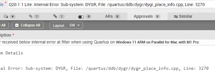

  • ShengN_altera's avatar
    ShengN_altera
    The internal error is not exist in Microsoft Windows machine. Seems like that internal error only appears on virtual machine in M1 MacBook. Previously there's a similar internal error on virtual machine in M1 Mac check image:
    However, based on previous internal message that we do not officially support the use model of Windows running within VM in MacBook check image:
    Sheng
