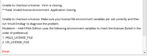

Unable to checkout a license. Vsim is closing.
** Fatal: Invalid license environment. Application closing.
Unable to checkout a license. Make sure your license file environment variables are set correctly and then run 'lmutil lmdiag' to diagnose the problem.
Modelsim-Altera uses the following environment variables to check the licenses (listed in the order of preference)
1. MGLS_LICENSE_FILE
2. LM_LICENSE_FILE.

Hi
Could you provide message screenshot and error message for checking
- ZCE00
- ZCE00
