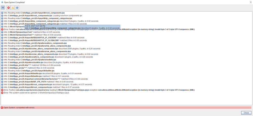

Hi Ben,
I have sent an email to you. Please help to check.
Shyan Yew
I haven't see this error before.
Which OS that you are using? Have you try to clean and rebuild your project?
Could you help to share your design so we could check on this?
@RichardTanSY_Altera , I emailed you the Qsys. Good day and thank you,
- RichardT_altera5 years ago
I tried to open the qsys.qsys file that you provided.
Unfortunately I don't see the error message pop up, other than the warning messages pop up saying a lot of IP files missing.
Have you try to uninstall/reinstall the Quartus and try to migrate the project again?
- SLabe5 years ago
Very sorry, the Qsys we'd shared was 20.3... I've emailed you the 20.4. Let us know of you findings, thank you.
- SLabe5 years ago
This is the screen you should get when opening the latest Qsys. Thank you.
- Ben_C5 years ago
Hi Shyan Yew
I have sent you the file by e-mail
regards
Ben

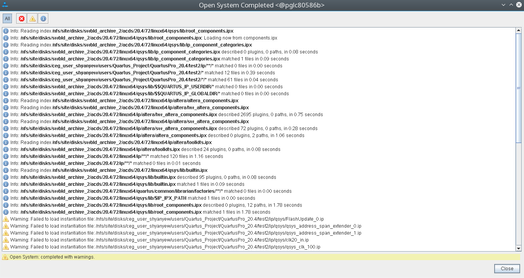

Sorry for the delay in response. I just back from CNY break.
I open the new qsys file again and I got the same scenario as the previous file - not able to duplicate the error and system completed with warnings saying: Failed to instantiate file.
Here's the flow that I go through. Let me know if there is a different flow with yours.
1. Open a new project in Quartus Pro 20.4
2. Add the qsys.qsys file in the project
3. Launch the IP upgrade editor.
4. Open the qsys file in Platform Designer.
5. System completed with warnings. (see below)
